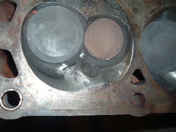

Finally can start putting it together now that the piston doesn't hit the bottom of the head. Had to take the shortblock & the heads to a local shop to have them fix it. Just happy now I can start getting it back together-finally!

I dont get it windsor what did they do to the heads ? And the piston doesnt hit the bottom of the piston ? Or did u mean the piston doesnt hit the valve ?

My bad. Meant to say the piston hit the bottom of the head. Found this out after I tried turning the motor over and it just stopped. The shop and to grind the chamber to match the contour of the pistons due to the large dome on the piston. It's hard to tell but there was A LOT of grinding that had to be done. I guess it's just the cost of having custom pistons.
