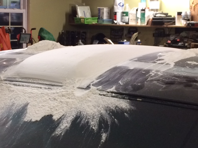

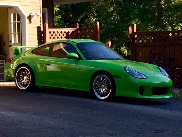

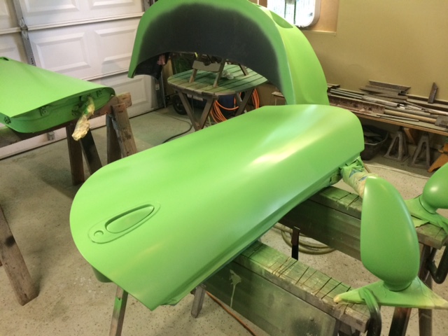

My current Porsche is a 1999 911 Carrera. I purchased it from Georgia and had it shipped up here to lapeer. I drove it for the first summer and that following winter I ripped it apart, cust it up and MADE my own steel wide body and body kit for it. Things I did in short.. very short is I made my own molds and parts for side skirts, roof scoop, rear bumper and steel flares. I redid the entire suspension with performance stuff, built my own exhaust system which sounds out of this world, redid the interior to match the paint job I did on it in my two car garage and did some go-fast engine mods as well.
The car is amazing to drive, gets more attention then all my past cars combined lol and I'm just really enjoying it. I would post up a link to the build thread but I'm not sure if this site would allow that so I can pm you a link if anyone is interested. It has had over 40k views and my car has had an article written about and I am currently working with someone on another article (more in depth) for the car.

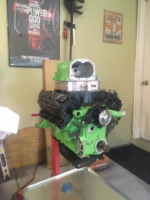

These pictures are just yummy lol
I feel like lightening is going to strike every time I get within touching distance to this motor :icon107: lol

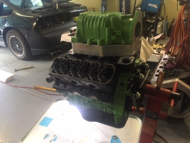

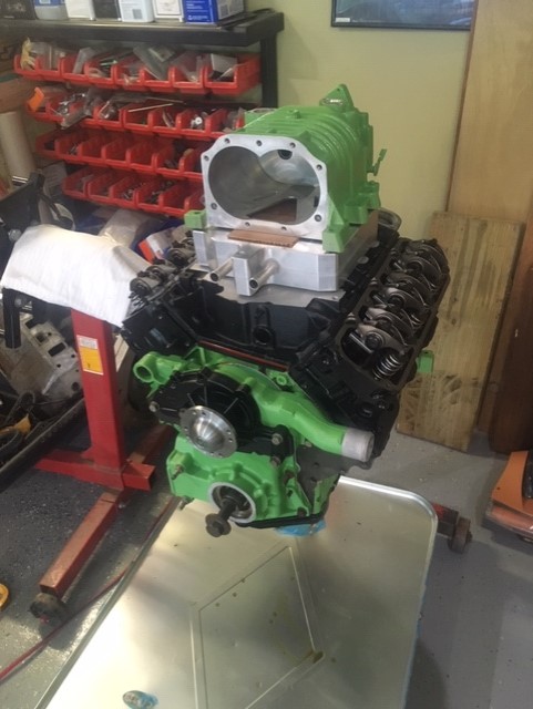

Getting closer. So quick question, does anyone know off the top of there head what the total height (bottom of oil pan to top of intake) of the 3.4 Porsche engine is? I measured my boxster couple years ago and it was 26"' I will measure the 911 set up tonight to confirm so no worries if not. Waiting for a few parts to come in and this motor will be done and ready to start the swap.
So far my concern is going to be height of this set up. I can swap out intercoolers which would drop it by 1" but I'd really like to keep the 2" (tall stack) cooler under that charger. It will allow me to get closer to my HP/TQ goals. Fabbing up a sheet metal hump/bump in the rear where the speaker box is doesn't scare me but where the supercharger snout comes toward the rear hood... that's what I'm concerned out. I might need to notch it a little bit. As long as I can re-create the drip edge and close the hood with out it being seen.. I'll be happy. if not.. I'm going to have to think up another option such as shorter oil pan or the shorter intercooler.

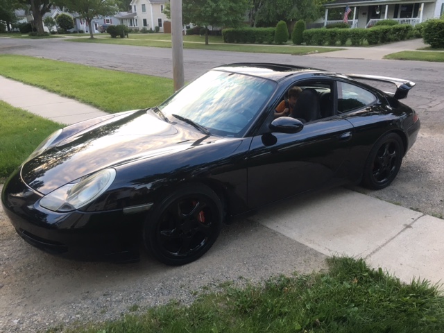

Last picture, a friend sent me that picture from facebook(I don't do social media) someone took that of my car at cars and coffee last weekend .. that was cool to see my car pop up online lol so thanks to who ever that was :thumbup:
