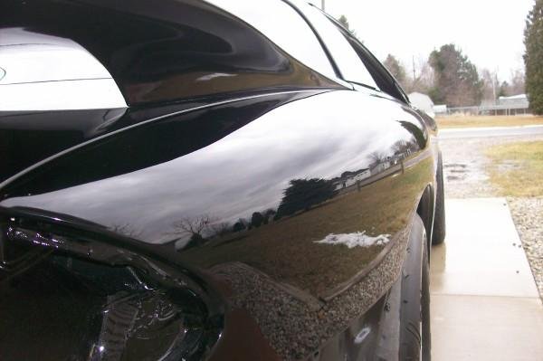

Unread 12-28-2010, 03:35 PM   #12
Here is some work with the finishline. I love the gun for basecoats. But clears I just had to move way slow to get it to lay flat. This is after polishing.
This is the clear out of the PLUS gun. I'm very happy with it.
